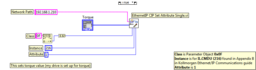

For those that want to use the Ethernet/IP add-on for LabVIEW (this is 2018), here is how:get.PNG
set.PNGThe Instance numbers come from Appendix B of AKD EtherNetIP Communications Manual EN REV 20H.pdf
