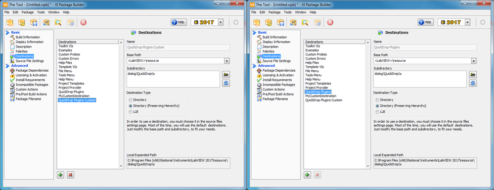

I would like to share with you with some weird behavior that VI Package Builder presents. I found 2 bugs (probably related to each other).
First Bug
VI Package Builder allows configuring package files destination. In Destinations pane you can see built-in destinations, which can be altered to suits your needs.
As you can see QuickDrop Plugins destination name cannot be altered because it is built-in.
I can add my own destination and then customize it as I like. However, when my custom destination name starts with the name of one of the built-in destinations, then the bug reveals.
In the custom destination, the name cannot be changed and it is now magically linked with the built-in destination. So if I change the subdirectory in my custom destination, the built-in will change as well. I'm afraid it is not a feature.
Check this behavior with The Tool - 1.vipb file.

Second Bug
VI Package Builder Test.lvproj contains files which mimic QuickDrop files (these are empty files, placeholders). The Tool - 2.vipb file should install this QuickDrop. Desired files location after installation should look like this:
C:\Program Files (x86)\National Instruments\LabVIEW 2017\resource\dialog\QuickDrop\plugins\Tool.vi - Main QuickDrop VI
C:\Program Files (x86)\National Instruments\LabVIEW 2017\resource\dialog\QuickDrop\plugins\_The Tool\Tool Support 1.vi - Support file
C:\Program Files (x86)\National Instruments\LabVIEW 2017\resource\dialog\QuickDrop\plugins\_The Tool\Tool Support 2.vi - Support file
C:\Program Files (x86)\National Instruments\LabVIEW 2017\resource\dialog\QuickDrop\plugins\_The Tool\Tool Support 3.vi - Support file
The configuration is as follows:
Package Source use MyCustomDestination (MCD) which is C:\Program Files (x86)\National Instruments\LabVIEW 2017\resource\dialog\QuickDrop\plugins\_The Tool. Tool Support use parent folder destination which is MCD. Tool.vi destination is built-in QuickDrop Plugins destination which is C:\Program Files (x86)\National Instruments\LabVIEW 2017\resource\dialog\QuickDrop\plugins.
Installation effect is:
C:\Program Files (x86)\National Instruments\LabVIEW 2017\resource\dialog\QuickDrop\plugins\_The Tool\Tool.vi
Clearly not what I need and what VIPB configuration states.

Hi @bienieck,
Thanks for pointing out that unexpected behavior. It's good to be aware of on our end! However, because VI Package Manager is made by JKI and not by NI directly, these bug reports will probably get a more helpful response if shared on the JKI VIPM forums.
Thanks again for your diligence in sharing these!
