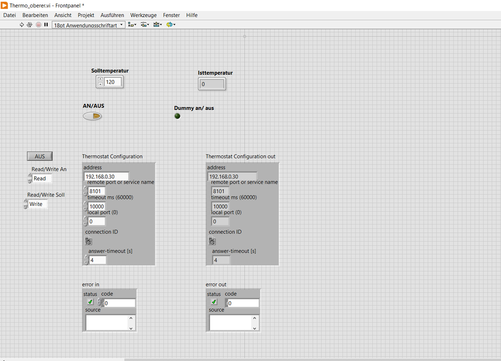

Thank you for your answer. In the meantime I have built something else with the different drivers. The drivers were already there (temperature control and setpoint temperature).
The goal here is:
- Switch the thermostat on or off
- Set the target temperature
- Call up the internal temperature
I always get this error message:
Invalid input parameter. For example, if a path is present at the input, this path may contain characters such as ? or @,
which are not permitted in the operating system.
This command can only be used if the GPIB controller is the active controller.
Enclosed I am sending you the programme. I would be very grateful if you could help me.

First of all, thank you for the answer you sent me last time. This allowed me to finish my assignment.
I have been trying to find a way to control the scale, but I keep getting the following error codes: 1073676294 and -1073807252. I am having trouble getting through. I don't know what to do.
I have to tare the scale and then read the actual weight of the scale. For this purpose there are already the appropriate commands and drivers.
As attachment I send you everything I have done and you can see and tell me where the fault lies.
I really need your help to be able to continue.
