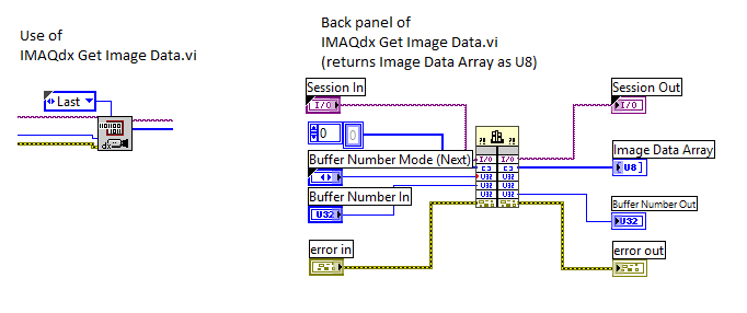

This monochrome camera has the option of supplying images in a "Mono 8", "Mono 12", or "Mono 12p" format, meaning 8-bit, 12-bit, or 12-bit packed. I think when using Mono 12, the camera should return a 16-bit number for each pixel (with four zeros as the most significant bits), and when using Mono 12p, the camera should return a 12-bit number for each pixel, though I have to check more carefully.
So far I've had good success using Mono 8, using the VI "IMAQdx Get Image Data.vi" to grab the image data for each frame. However, this VI returns the image data array as an 8-bit U8 array, which is causing some unusual images if I set the camera to Mono 12 or Mono 12p.
Furthermore: When using Mono 12, IMAQdx Get Image Data.vi returns an image array with length 2x longer than with Mono 8. Similarly, when using Mono 12p, IMAQdx Get Image Data.vi returns an image array with length 1.5x longer than with Mono 8. Everything works properly when testing the camera with NI MAX, but it misbehaves when I use my own code with Mono 12 and Mono 12p.

What image format are you using when creating the IMAQ image? Typically that has to match with what you later try to copy into the image,
so try to select a i16 or whatever it is called format when creating the IMAQ reference.
I just see that you do direct grab into a memory buffer not an IMAQ reference. In that case the Unflatten from String function might work a lot better than what you can do. Run the byte array through a Byte Array to String function and then to a Unflatten from String. Connect an empty I16 byte array constant to the input, a false to the “contains length” input. Now you can play with the Endian input. It either needs to be big endian or little endian. Also depending on the data format of the camera it may work better with an u16 array constant.
This definitely won’t work for packed formats. There you need to do the unpacking somehow and there are way to many possible variables to expect IMAQ to provide ready made functions that would support them all.

1. I made a version of IMAQdx Get Image Data.vi, which passes an empty U16 array to the DLL call and outputs a U16 array (instead of U8 for both, as in the screenshots above). I also pass it a U16 IMAQ image object to "IMAQdx Grab2.vi" instead of a U8 IMAQ image object. It seems to work slightly better, though there are still some issues:
- It still returns an array that's still 2x longer than it should be (4608000 pixels instead of 2304000).
- What used to be a ~100 pixel brightness with Mono 8 is now a ~1600 pixel brightness with Mono 12, which is good.
- For some reason, elements 2304000 to 2326519 are all zeros, and many array elements beyond 2326519 are greater than 4095 (what should be the maximum for 12-bit data). The actual array should have an index from 0 to 2303999, so I'm not sure what this indicates.
- This test also crashes quite often, so it's difficult to troubleshoot.

@pmk01 wrote:
Thanks for your suggestions - here are some updates:
You can't do that! The function in the DLL does not magically know that you have wired a I16 array to the terminal. So it goes and allocates a byte array with the necessary size (width + padding) * (height ) * 2 (for the I16 values). Then it fills in the data and in the 32-bit length value for the handle this number. Now this array is returned to LabVIEW and you told it that it is an I16 array. So LabVIEW interpretes the length parameter as the number of I16 values and Booooom, it accesses a memory buffer that is double as large as it really is. No surprise you see strange values after the half of your buffer, those values were not only never initialized by the function, but don't belong to the actual array (and image) but are instead just some other data in memory (and can even reach into address space that is not currently mapped to your process, which is what causes the crashes).
And no you can't place a Resize Array after the function call to resize it to the real number of elements. Resize array MAY simply update the length value but it MAY just as well decide to resize the handle for real and Booom again as the memory manager is told to resize that handle that doesn't really have the number of bytes it assumes to have.
Even updating the 32-bit length value through direct memory access (for instance calling MoveBlock function) wouldn't be safe as there is a small time window between when the Call Library Node for your function returns to when you call the Call Library Node for the MoveBlock call to correct the length value, where the array contains inconsistent data and might crash under some conditions (for instance if someone debugs the code and places a probe on that wire).
Rolf Kalbermatter  My Blog

Thanks for the info - that makes sense. I assumed this would work from looking at the back panel of IMAQdx Get Image Data.vi
Can you tell me what DLL call I should use instead to do this properly?
Thanks again!
No I can't. Most likely this function does not exist in the DLL. The problem about data types and C programming is that one needs to write one function for every datatype. And most of each function is the same with a few minor differences. Not something that gets done just because it is fun.
Every graphic library written in C has to fight with this unless you use variant data types, but they have other problems such as being less easy to handle and you loose some performance as you have to check all kinds of things every time you want to access the data in the variant.
