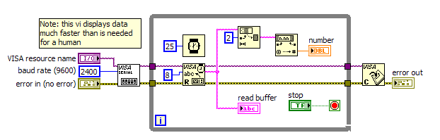

 Taking your advice about reading the VISA more carefully, here's what I came up with. There is no termination character, but the repeating data is always the same number of bytes with no invisible characters. It is a continuous stream of "= 0017.9= 0017.9= 0017.9= 0017.9= 0017.9= 0017.9= 0017.9= 00". I have hit a snag though, and I've seen it before so I'm sure someone else has as well. Take the example data stream above. The string I read out would be " 0017.9" but the number I get out of the "decimal string to number" VI is only "17". I'm sure this is a simple fix, but could someone point me in the right direction?
Any other criticisms of my method would be well appreciated. Is there anything I should consider in using this as a subVI?

Short Answer: Try this code and post your results.
Long Answer:
From looking at your code (and your posts) I see the following:
The serial instrument you are getting data from puts out a steady stream of data at 2400 Baud in a format that is “= XXXXXX\n”. Where the 6 “X” bytes are a floating point string preceded by a space character. So there are 8 total data bytes.
Now you might be surprised that I show a linefeed (\n) in the data format because you said that there is no termination character. Well you are right in a way because you will not see the termination char in your read buffer data. However, if you look at the “VISA Configure Serial Port VI” detailed help, you will notice that the default settings are to: “Enable termination Char” and “term char = \n” (inputs at the top of the vi).
 The reason this is important is for the Visa Read function. Since by default you have set your serial port to use a term char, the only way for the Visa Read function to complete is for it to receive a termination character or a timeout. Since you are not timing out, I know that you are getting a termination character and it has to be a “\n” to match the settings. The VISA read does not pass the term char on so you never see it.
In your first VISA Read you are asking for 1 byte of data. Based on the above info, your VISA Read must actually read 8 bytes + the term char before it will finish. So you are only pulling out part of the data that was read. The subsequent reads are doing the same thing. I believe this is why your data is getting jumbled.
So try this: Set your byte count to 8 and only use one read routine.
NOTE: In your while loops you do not have any delay which means you are really pounding on the read routines. Since your data is coming in at about 30 readings a second, it would be good to put in a ~25 millisecond delay because the reads can’t happen any faster than that.
