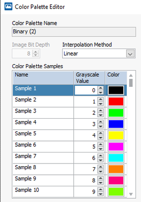

If you just want to display your binary image with another color couple, you can simply edit the binary palette used to display the image:
Using Vision Assistant 2020:
1. Make sure your binarization step is selected:
2. Make sure the Binary palette is selected, then edit:
3. There you can select a different color for each value (0 and 1 in your case):

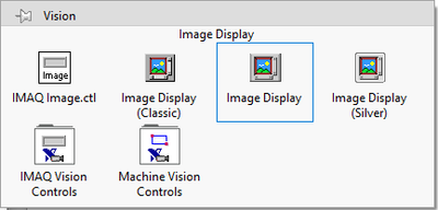

Using LabVIEW:
1. Create an IMAQ Image control:
2. Configure a user-defined palette programmatically using property nodes on this control:
There you can specify an array of up to 256 elements, giving the display color for each individual binary group (starting from 0 to 255).
