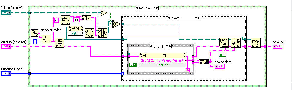

Hi John,
Well, it would be nice if a VI could save itself, but unfortunately, that's a limitation in LabVIEW since you can only programmatically save a VI that is not running. However, using VI Server you can get around this limitation by using a "Launcher" VI that makes the current values default and then saves the VI.  Here's an example of such a caller:
Notice that it is not possible to only make certain values default while keeping others - you can only choose to make ALL values default using this method.
Of course, you can also use the method discussed earlier, to save your values in a file. I have created a small VI called "GetSetCtrls.vi" that you can drop different places in your VI to load and save control/indicator values. Here's the diagram of "GetSetCtrls.vi":
Currently "GetSetCtrls.vi" handles ALL existing controls and indicators, so if you only want to control a few, please make the necessary changes to the code yourself, thanks.
Have Fun!

Thanks Phillip! It looks like your vi will do nwhat I need.
John
