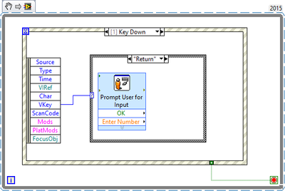

I am not sure what you are after.
If you just want a user input box to come up when the user presses enter you could do something like this...although I suspect I have misunderstood what you are after.
