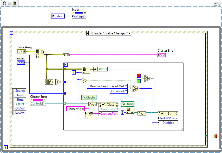

Crossrulz is correct, but you can work around it, though i'd say it's probably not really worth it. 🙂
What you can do is use Array to Cluster to get one big cluster instead and handle the color and disable status of the parts.
Color array backgroundColor array background
Front panel screenshot taken before i fixed things up.
