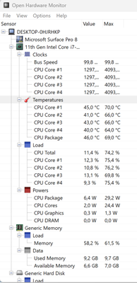

Is it possible to access motherboard's built in temperature sensors using labview?
First of all: THANK YOU ALL for this VI!
I modified it a bit (see screenshot), to suit my needs.
Any Information that i want to process, i just extraxt out of "Extra Info" via Regex:
And with that i have a Simple Graph that shows me the Temp of my CPU and my GPU. 😃
The only thing left to do for me, is to extract the other Data (like Core Power for every Core) and display it.
openhardwaremonitor.exe needs to be running with admin-privilegs, otherrwise (as a standard windows user), you get "nothing" for the temperature readings.
started as admin-user
started as standard user
same behavior when for C# console app with
using LibreHardwareMonitor.Hardware;
