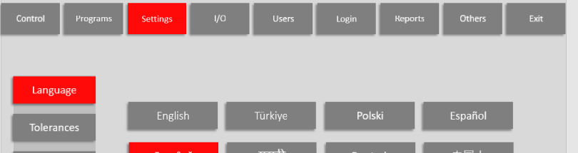

Is Similar button available in Labview Pallette or should i make customized one?

Hi power,
classic palette -> simple rectangular button. Then apply colors as needed.
(When you need the shadow you will need to customize the button…)

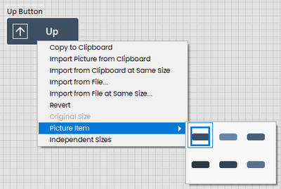

But I have another question. Just curious - which control was used as template for this button with rounded corners? Usually when graphic is inserted as picture items, then the radius of the corners will be resized together with control, but in this case it keep the shape, for example, compared with Classic Control:
And this is the button with six states:
How to create such customized control step by step from the scratch?

@Andrey_Dmitriev wrote:
Also don't see increased CPU usage with this VI on my PC (LabVIEW 2023Q3 x64/Win10).
The secrete is in the image imported during customizing, not in the original control.
I don't know which image they used.  There are a few such images available.  See attached VI.
