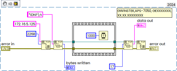

I'm interfacing APS 7050 power supply with LabVIEW through Ethernet, but I'm not able to do it. On the APS 7050 power supply website they have drivers which can connect through serial, but I need to connect it with Ethernet and that drivers are not available with them. So, I'm using TCP/IP communication protocol from LabVIEW to interface. I have created one block diagram attached below in which TCP/IP open and writer operation is performing but Read operation is not working giving Error 56. I'm referring User manual and Program manual. They have provided some commands to control the power supply.

The very first problem which I see is your attempt to get 1024 bytes back:
According to documentation the response to the command "*IDN?\n" will be
GWINSTEK,APS-7050, GEXXXXXXX,XX.XX.XXXXXXXX
Which is the only 44 bytes. Try to read exact number of bytes returned back according to documentation (don't forget about termination char).
For the first attempt send "*IDN?\n" and try to read 17 bytes only (the rest will remain in TCP buffer) , you should get back string "GWINSTEK,APS-7050" Then increase amount of bytes to get full string. Do not do this in the cycle, for the very first experiment something like that shall be fully sufficient (later, once working, you can add polling cycle, of course):

Hello Andrey_Dmitriev,
I have changed that bytes to read to 17, still I'm getting error and not able to get response. I have choosen Immediate mode.

Did you try following the instructions starting on page 37 in the manual to set up a VISA socket connection in NI-MAX?
https://www.gwinstek.com/en-global/products/downloadSeriesDownNew/8395/562
It is entirely possible that if you do so, you can use that VISA address to use the LabVIEW drivers you already have.
Also, with just the screenshot I strongly suspect that you are not sending the termination character on your *IDN? request properly.  Are you sending two characters, "\" and "n", or do you have "slash codes" turned on to be sure you are sending just one character, the invisible ASCII character for "new line"?
Message 5 of 13
(2,044 Views)
Yes Kyle, I have followed that from the manual to check the connection and it seems ok. Thank you for the response. I'm able to communicate now with supply. the problem was TCP/IP port was not closing properly that is why it was giving me ERROR 56.

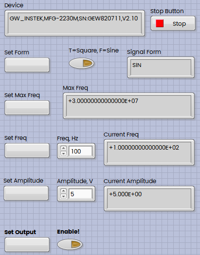

Hey Andrey, thanks for the help, I'm now able to communicate with supply. basic commands are working such as IDN, measure cureent and voltage . But I want to set the voltage , current and frequency through LabVIEW and whatever the commands given in programming manual are not giving me output. I think I'm missing in syntax of command, can you please confirm once from your side. Please try for setting voltage, current and frequency by using their commands.

Here the snippet with functional code for my MFG-2230M (set Form, Freq and Amplitude only):
There are some "combined" commands available, where I can set all params in single command, but for me more convenient to set these separately.
It also perform query after set, but you should keep in mind, that the device need some time to set parameters, therefore immediate query will not work (I put 2 sec delays between set and get, not very elegant, but works). This is result:
Hope it helps.

The idea to require to request exactly the right amount of bytes is a VERY brittle solution. If you happen to use a different instrument with a slightly different firmware version, this string can easily change (even just the firmware version number might have a different number of characters)!
So lets analyze the thing:
1) Right click on your IDN?\n string constant and select Visible Items->Display Style. What glyph does appear on the left border of the string constant? If this is not a \, you are not sending a line feed character but simply a backslash followed by an n. The device will simply think WTF, but not produce any response since it expects a line feed (or maybe carriage return or both) before it starts to act on the command.
2) The LabVIEW TCP Read function has various read modes, including terminating a read on carriage return + line feed,  but your device may not be able to set to return both these characters at the end of a response. So trying to reliably read from the device gets tricky. If you instead use VISA, you can configure the termination character on which a read should terminate and suddenly it does not matter if you specify to read 1000 characters on the VISA Read. It will return as soon as it sees the line feed character that your device is most likely returning on every response.
This should help with most of the trouble you seem to be having.
