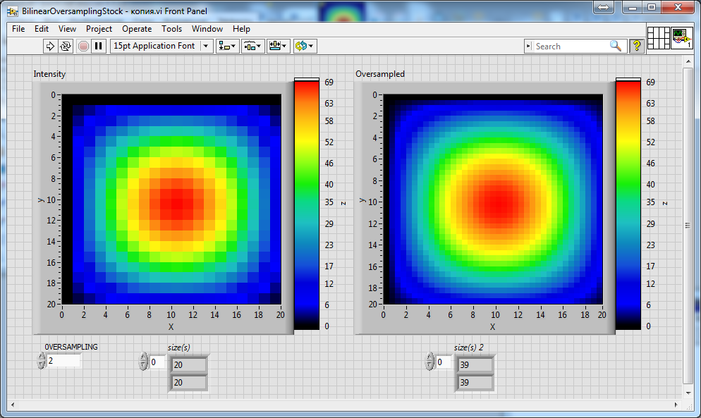

Hello everybody!
Can someone help me to improve the attached above vi's from altenbach to achieve a correct scaling factor relatively to the resolution of an input image/array? I will try to explain: if you set the scaling factor 2, you expect that the resolution of the input array or image (for example, 20x20) turns into 40x40 as the result. If you set scaling factor 3, then 60x60... And etc. But all of these attached above vi's can't do this thing. None of them... For example, I add only just 2 indicators on the front panel of each vi (attached above by altenbach), these indicators only display the size of the array before (left) and after (right) the oversampling:
Spoiler
So, as one can see, there is 39x39 after oversampling by the "Stock" version of the vi with scaling factor 2 (see control "OVERSAMPLING")...
Spoiler
And there is also 41x41 instead of 40x40 after oversampling using the vi written by altenbach with his own code.
I would be very grateful to altenbach (or anyone else) if you could help me with modifying these excellent algorithms to make them even better: to make it working more accurate in terms of resolution.
In particular, in many many applications, you need only just to increase the resolution a multiple of times (in my task the same). And the enlarged image then should be treated by another algorithms. But these algorithms very often can not handle an array, if it consists of an odd number of rows or columns etc. So, when we doing oversampling or antialiasing we often should accurately check how the vi working with output resolution.

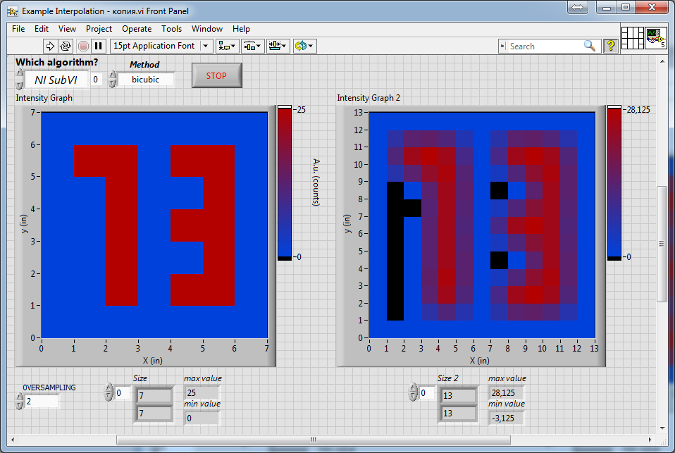

Another question on these excellent algorithms (for which I am, of course, very grateful to altenbach with all respect for his work for us) is that they do not work correctly with the "nearest" mode of "stock" interpolation (I set it on the block-diagram):
Spoiler
It is obvious that problems with the Nearest mode arise precisely due to NI interpolating algorithms inaccurate work itself with the resolution of the array/image (and "Mimic" versions just copy they code). This is manifested not only in the "Nearest" mode, but also in other modes, but in them it's just not as noticeable on such a smooth test object. If we take another object, then in the modes "Cubic" or "Bilinear" it will also be more obvious:
Spoiler
Let us compare the results presented above with the result obtained with proper accounting of the array resolution:
4. Spline by DonRoth.pngAs one can see, in the last image, the thickness of the lines composing the number "3" is much closer to the original, compared to all the previous ones (which look very thin). The last result was obtained on the basis of the algorithm from DonRoth, which was attached with his post in this topic: https://forums.ni.com/t5/LabVIEW/2d-image-array-smoothing-algorithm/td-p/740816.
Of course, I could use this subVI from DonRoth, but its performance is not as high as "Mimic" algorithm from altenbach, so on large images the conversion takes seconds, which is unacceptable for our task. In addition, in our application, the most optimal will be the use of the "Cubic" interpolation, but in the algorithm from DonRoth "Spline" method was used. Therefore, I would like somehow modify "Mimic" vi's attached by altenbach instead of using this vi from DonRoth.

Hi nik,
The do work correctly!
They do exactly what you told them to do: to pick the nearest value…
Each interpolation style uses its own "assumptions" on the data - the assumptions could be true or false. It's up to the programmer to choose the "correct" style…
Well, I would never start to improve something provided by Christian! 😄
The solution to your question is quite simple: you need to set the Ramp function to produce a ramp with the "correct" number of steps…
