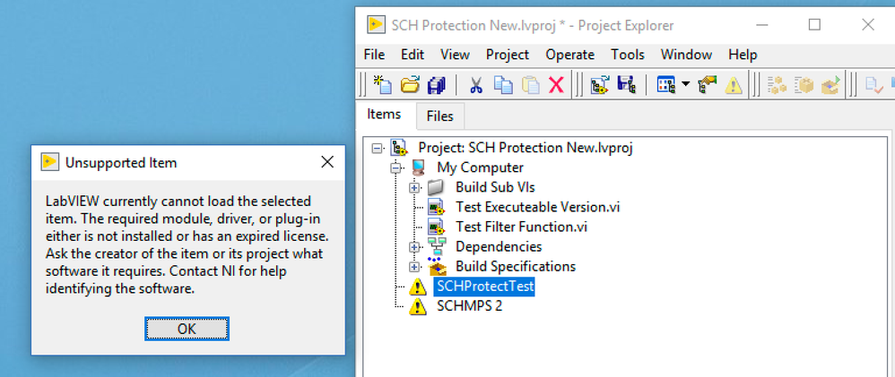

That is my guess here.  I did not have this issue with LV 17 and Win 10.  But I am windows impaired.  So I installed both LV 18-32 and LV 18-64 and as many compilers and FPGA modules as I can.  I then moved my LV 17 project over to this new VM system and opened it.  Under LV 18-64, I get the following:
LV 18-64LV 18-64
I then open the project under LV 18-32

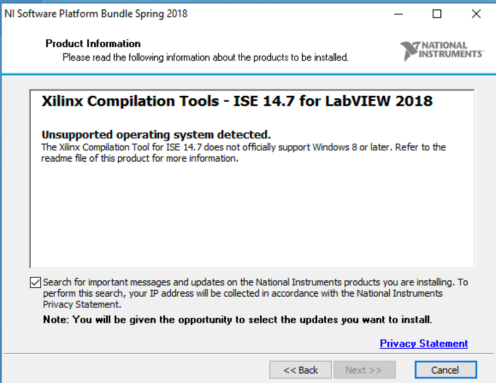

So I go back to my Academic LV 2018 NI Platform Bundle Spring 2018 and select as much as possible.  The first error is that the RT module does not allow selection of LV 18-64
Selecting RT moduleSelecting RT module
So going ahead with the install, without LV 18-64 I get that the older Xilinx tools do not install.  Fine, don't need them at the moments, so deselect them.
Can't install ISE Xilinx toolsCan't install ISE Xilinx tools
Now I get one last issue:
Now it tells me that the older Xilinx tools are necessary.  The compiler has completed the loop and the Catch 22 is complete.

The ISE Tools are definitely not supported on Windows 10, only Vivado. I agree that there seems to be an installer problem since the 32-bit FPGA Module shouldn't be requiring you to install the ISE Tools. Something you could try is to install the following from your USB media:
  1. LabVIEW 2018 32-bit (and 64-bit if you want it, although you won't be able to program the cRIO with it).
  2. LabVIEW Real-Time 2018.
Then download and install the FPGA module from NI's website:
LabVIEW 2018 FPGA Module
After that is installed, are you able to install just the Vivado Tools from the USB installer?
-Jordan
Message 7 of 11

Yes, that works and installing the FPGA module from the download instead of the install media works!  Please try to get the installer fixed for those installations where network access is restricted.  It would be great to get a CAR on that.
