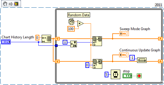

As a quick example of how to implement this using a preallocated array and a graph instead of a chart, see the following snippet which implements two different behaviors of displaying the data.
To change the direction of the Continuous Update Graph, change the -1 to a 1 on the rotate array.
Regarding your statement about the memory usage of the waveform chart: the memory for the waveform chart is allocated at runtime , so it should not be growing in memory usage. If you can attach a sample VI where you see this behavior of the memory usage growing quickly (500 byes per point is very significant) I will look into whether it is a possible CAR. One other thing to consider when using waveform charts for large data sets is the following knowledge base about why you should limit your chart history size.
