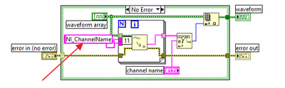

I have an array of digital waveforms. I want to index them by channel name and not index. This makes fro more readable and less easily breakable code. Each waveform is named a unique name. I can index a particular channel by integer but I cannot index a channel by name.
This works:
This does not:
I have confirmed the name in the channel definition. I have also indexed the channel index and retrieved the name using "NI_ChannelName" and the correct name is retrieved. I am not getting any errors.
What could I be doing wrong?

I found the issue. There was a bug in my version of the prewritten VI shipped with LabVIEW “DWDT Index Channel by Name.vi” that indexes digital waveform arrays by name. It was looking for the attribute "Channel Name" when it should have been looking for "NI_ChannelName". This caused the VI to noty find anything because there is no attribute called "Channel Name".
Bug:
Fixed:

I've been struggling with this with a NI support person since May 25th. I was trying to get a digital waveform out of a digital waveform array by channel name. It wasn't working. As I looked into this I found what I think is a bug.
Index waveform array is polymorphic. It will allow you to search for a channel using a channel name string.
Analog waveform array case:
If you wire an array of analog waveforms to the waveform array and a string to channel name then it finds a waveform in the array by channel name. The vi that does this is called "WDT Index Channel by Name DBL.vi". It uses "NI_ChannelName" as the attribute name to search:
Digital waveform array case:
If you wire an array of digital waveforms to the waveform array and a string to channel name then it should find a waveform in the array by channel name. The vi that does this is called "DWDT Index Channel by Name.vi". It looks like this and uses "Channel Name" as the attribute name to search:
I have attached a VI that works for analog but not for digital. If someone could please confirm that the analog version works but their digital version does not in your environment I would greatly appreciate it.
Is this a bug or am I misunderstanding something?

Flycast, you are correct - index digital waveform by name uses "Channel Name" not "NI_ChannelName" as all the other index by channel name options in the polymorphic vi. I have to call it a mistake or bug, why would the digital index by name be different from all the analog index by name options.
Good find!
