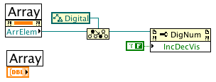

There is a trick : since there is no way to tell if an array will be made with simple digital controls of anything else, there is no specific property node to hide or display the inc/dec button. But of course, you can access to this property if you tell LabVIEW that your array element is a digital control...
... as done in the picture below.

I think this works only for an array, but how can I do the same thing
when I have a cluster of{cluster1, cluster2, cluster3 of{array1,
array2,control)}? I want to influence the visibilty i.e. in array2!
Urs
(4,671 Views)
You just have to apply the same technique to the various elements of your cluster : first get the references to the cluster content, then scan to find which one correspond to the sub-cluster you are interested in, and so on. This is illustrated in the attached vi, saved in 7.0.
