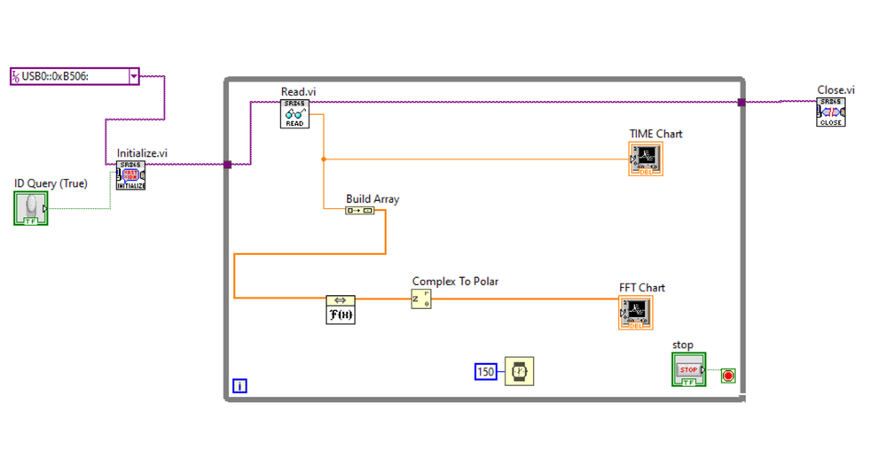

I am performing the FFT of a waveform measured by sr860 Lock-in Amplifier. But the FFT shape is wild. It appears to be incorrect. I have attached a screen shot of my Labview front panel and block diagram..Thank you for your assistance.

You are taking the FFT of a single point during each iteration. You need to have an array of points. Two options, wait until you collect all the data then do the FFT, or do a point-by-point FFT. I don’t have access to LabVIEW now to see if there is a point by point FFT function.

Use the FFT function from the Point-By-Point functions palette - instead of the FFT you use now…
You should understand the datatypes you use in your VI(s) and know which datatypes are useful for your  task(s):
  • a FFT from an array of a single element is mostly useless
  • a FFT from an array containing lots of samples is most often preferred…

Thanks GerdW!
it works
