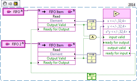

My first naïve attempt was to do something like the following:
(ignore the dodgy FIFO, that's just for example I/O).
The problem is: this code will fall down if one of the inputs is valid while the other isn't. We'll lose the valid data, and only be able to perform a calculation if both inputs happen to be valid simultaneously. (I think this is difficult to guarantee if the input data come from different sources, e.g. maybe the host and over p2p).
The new linear algebra palette solves this problem by having separate handshaking for each input.

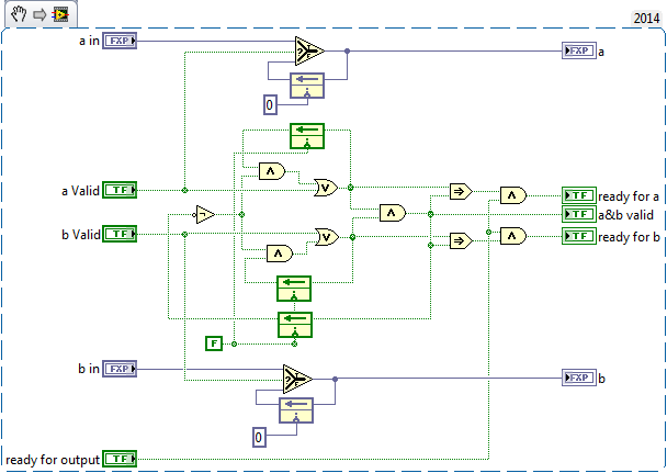

I guess we need to implement something analogous for the simple multiply? As below.
This middleman needs to hang-on to valid data in either input, outputting only when both inputs have been valid. It should only ask for input if it is not already storing valid data from that output. Here is my attempt at coding this (also see attached).
Obviously, there are plenty of problems with my implementation – primarily, the introduction of latency and complexity to the FPGA.
I suspect others must have run into this issue, and so I’m sure there are better solutions. Does anyone know of any, or have advice on how to improve on my attempt?

Why not just buffer them yourself with a feedback node and store the values when they are ready from your input FIFOs and empty them when they are read out?
I don't see the benefit of pushing this work into a primitive.

Thanks for the response.
Firstly, I don't think I've explained myself very well - I'm not suggesting that NI add a primitive to solve this problem, merely that it's a problem I would like a solution to.
And I'm not quite sure I understand your response (sorry!). Do you mean buffer the input data only when they're valid? As below.
If so, you still have the problem that you might be losing data. I.e. you can’t guarantee element n of FIFO 1 is multiplied by element n of FIFO 2, if they are not ready on the same iteration.

I forget (and I don't have LV here), but can't you query the no of available elements in the FIFO? If so, the easy way is just to ensure they both have an element, then only read and pass them when that is the case.
Using latches to store valid values is also a way to go, but there are problems with your implementation.
For starters, the state of the latches, not the multiply, should determine whether a 'ready for output' is passed to the FIFOs.
'Input valid' on the multiply should be set true when the latches are both 'full' with new data, not when both FIFO outputs are valid. I would maybe use a couple more latches which store a boolean indicating whether the buffering latches have valid data. (latch==FF node)
Message 4 of 9
(4,781 Views)
And don't forget, the FF node output only becomes available one cycle after it is fed in.

Thanks both for the suggestions.
Shane, that makes sense to me, and looks like a good implementation. And, FYI, the handshaking interface for the FIFO was introduced (I think) in LabVIEW 2014.
ToeCutter, I like the idea of using the FIFO state to check whether any elements can be read - I didn't think of that.
