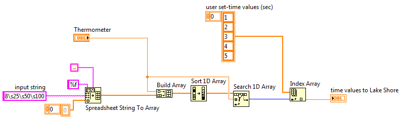

build an array with your ranges and temp. re arrange thru sorting, then search temp index and output with user set times

you did'nt understand my previous explanation? ok, your temperature value is put into an ascending array with your range values...that index will point to another array of user set timed values.
  • if temp. value is less than your range #8, then index is "0" on the ascending array, this will corespond to the user set time value index "0",which is currently set to 1
  • if temp. value is between your range #8 and #25, then index is "1" on the ascending array, this will corespond to the user set time value index "1",which is currently set to 2....and so on
these user set time value constants can be changed to whatever you want, including making it a user interface control....don't forget to kudo help and or mark as solution Smiley Wink

see if this gets you closer....
Spoiler
Message 9 of 12
(3,815 Views)
Thanks for the quick reply, apok. Could you please briefly explain what this VI does?
