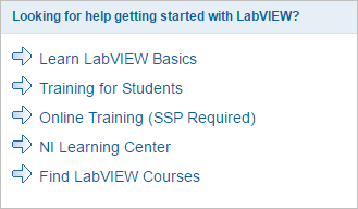

Go to the LabVIEW Forum, and look at the upper left of the Main Page.  Do you see this?
Click on "Learn LabVIEW Basics", and watch the first few videos -- it should teach you a lot and allow you to answer your own question (the best way to learn is by "doing it yourself").
