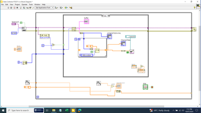

 If you don't mind, could you please advise me if I want to control the code running by the time? I want to set the code's running time to 2 sec/ 3 sec/ 5 sec; for that, which subVI or function could I use?
I attached the code (LV19) version.

Why do you keep attaching the same Rube Goldberg code over and over again, even though we told you how to simplify it by 90%! (... and please don't maximize the front panel and diagram to the screen!).
If you want to stop the loop after a certain time, it should be a while loop because you don't know the number of iterations unless you have a defined loop time. Do you? If you would define a loop time using a suitable wait, you could keep the FOR loop and calculate the number of iterations before the loop even starts. No need to even measure the time.
There are much easier ways to measure elapsed time than a gigantic express VI. You already measure the elapsed time, so all you need is a "greater than" comparison to stop the loop!
This is still an one-shot downhill program that requires the run button to start. Shouldn't this be a proper state machine instead?

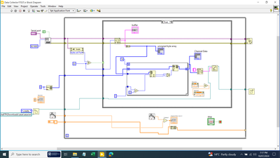

First of all, thanks for the guidance. I tried both options to simplify the code. A Simpler approach is working, and the best approach, unflatten/flatten subVI based, is not working in which I am making any wrong connection within a FOR loop / conditional loop due to that it is giving only for columns of an array whose all values are zeros.
I attached both codes (LV19) with this message.

Hi Hasham,
Nobody told you to use orange wires in this conversion step: so why did you use them???
