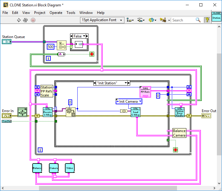

I've just finished a routine where a State Machine (actually a Message Handler "acting as a State Machine") controls multiple Stations that do Data Acquisition from VISA-controlled balances (admittedly not exactly high speed, 10 weights/second) and from TCP/IP Video Cameras (640x480, 30 fps).  However, instead of using a Queue and building a QMH, I used a Messenger Channel and built what I call a CMH (I'll let you figure out the name).  Works exceedingly well, extremely simple and elegant (I think).  The Messenger Channel sends around "messages" consisting of an Enum ("State") and a Variant ("Data"), often empty.
Here's a picture of the Station VI, which gets information from the Main VI via a Queue (top loop), has its CMH loop in the middle, and then communicates with three other parallel CMH routines that run the Balance, Camera, and control the production of AVI Videos if the Balance detects a significant change in weight (never mind what we're measuring ...).
For those who are new to Channel Wires, the pink "pipes" are the Messenger Channels.  Like Queues, they instaneously transfer data placed on a Channel Writer (buried inside sub-VIs, like the one called "Send C-Msg" in the middle of the CMH) to all connected Channel Readers (in this case, one inside the Camera Loop at the bottom -- follow the pipe).  Unlike Queues, Channels have "direction" -- data doesn't "flow backwards" from an Enqueue to a Dequeue, but always from Writer to Reader.  Note that the Channel "pipes" are shown "jumping over" the Case and While Loop boundaries, emphasizing that they do not obey "Data Flow", but are instantaneous transfers.
Message 5 of 43
