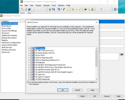

I can't build installer
when I try to build a installer, why it remind me "some installers you selected for this build are not available on this computer"?
and it will block build the installer, but actually my application doesn't need so much installer.
for same project, I tried on another computer, it is OK to build the installer, so, I want to know why it happen, how to fix it.
I really worry about I can't build installer in my own computer for any project.

Did you check the Additional Installers category? When left to automatic setting, LabVIEW often includes a lot of components you don't really need.
Of course, all depend on the specific application, but I guess that a seemingly test project as Untitled should not be so complicated. Are you including RT code? Shared variables? ...?

thanks for your reply, my code doesn't include any special component, just basic functions.
(123,370 Views)
but my computer has two versions of LabVIEW, 2020 and 2024, and I try to use 2020 to build a installer. because that's my development platform, 2024 version is for ensure I can open any shared new version VI.
