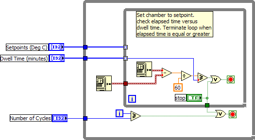

The missing code is the TestStand functions I mentioned. Just delete all of that and leave the code in the 'Chart' event. All that does is display a single profile that you create with a couple of arrays. The setpoint array and dwell time array along with the number of cycles is all that is required. Pass this information to a while loops with autoindexing turned on for the inner loop. The inner most while loop would terminate when the dwell time has elapsed. The next setpoint and dwell time would then be used. The outer while loop would terminate when the number of cycles has been performed. Here's a quick example of how it might look.

I don't really think an event structure would be appropriate for this type of application, as you are not taking in and responding to user input. Since you are going to have a collection of temperatures, and you go through each one, here is my idea for an architecture:
1) Make a 1D array of numerics, for your temperature.
2) Pass this into a while loop.
3) Take out the first element, set your setpoint to this.
4) Iterate until your specified time has elapsed ("dwell time", possible another 1-D array)
5) Repeat with subsequent elements of the array.
Hope that gets you pointed in the right direction!
