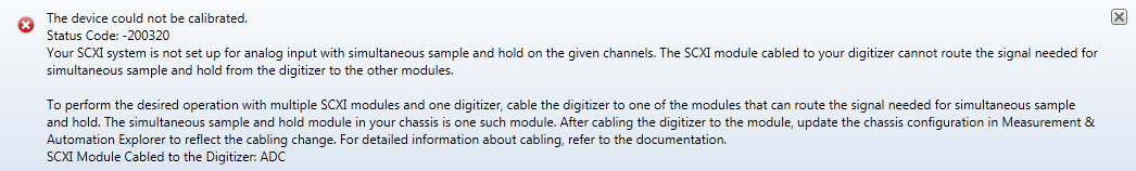

I do have a SCXI-1102, so I changed my system to be connected to the DAQ board as presented in Table 14.
Ok, when I try to get my SCXI-1530 to work, I get the following error.
For some reason, it seems that SCXI-1102 is not compatible with sample and hold function. For that reason, I must cable my DAQ to the SCXI-1530 and I have no more info about which analog pins are in use.
Is there any other reference with SCXI-1530?

When we have modules 15xx they have more priority than others, as you can see in the following link.
http://digital.ni.com/public.nsf/allkb/32DABC8E886A147086256F3900705D80?OpenDocument
So When have a SCXI-15xx module this will be always the module that communicate with DAQ board.
