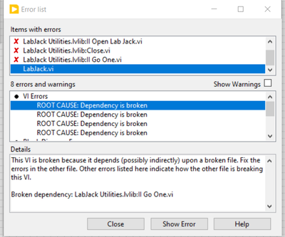

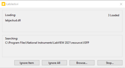

Thankyou for the support. But when I tried to access the driver without add-on,the dll error occurs.Screenshot is attached below.Kindly help to resolve the issue.
The errors in this screenshot appear to be related to the LabJack Utilities 3rd party add-on.
