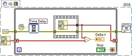

Ah, a Chance to Teach!  I'm deliberately going to go "old-school" to illustrate some important Principles of LabVIEW (including the Principle of Data Flow) and will not be using the Latest-and-Greatest methods, so these techniques will be applicable to single-digit Versions of LabVIEW.
Here's a little demo that times a loop (where the execution times are deliberately obscured -- I'll leave it as an Exercise for the Reader to determine the accuracies of the timing, mainly because I forgot to check it, myself).
This is a Snippet in LabVIEW 2018, but is simple enough that you should be able to recreate it in earlier versions.
Measure Loop TimeMeasure Loop Time
The basic idea is there's a loop with a Time Delay being set by a Random Number generator (so you can't "cheat") -- how long does it take the loop to run each time?
  • There's a critical Wire running through this VI, namely the Error Line, which should be central in almost every VI that you write.  Among other things, it provides a way to force the sequential execution of LabVIEW code (recall that the Principle of Data Flow makes LabVIEW do its best to execute everything at the same time if there is no data dependence between them).  We'll return to this shortly.
  • To get "elapsed time", you need to get "time", either as a TimeStamp (with Date and Time of Day) or as "ticks of a clock".  I chose to use TimeStamps.  For "elapsed" time, you need to know the time before and after whatever you are measuring, and then subtract them, right?
  • I start by getting the Time as I enter the loop, saving it in a Shift Register.  I then do the action I want to test (here a random Time Delay).  By putting the "function under test" on the Error Line, I know that it will be executed in "serial" order with every other thing on the Error Line.
  • What's next on the Error Line?  A Sequence Structure, with another Time function inside it.  Note that the "Error Line Runs Through It", which forces this Time function to run after the "Function under Test" (try running this example without that Sequence Frame).  Incidentally, this is one of the (very) few legitimate uses for the Frame Structure (in my humble opinion).
  • So we have (on the Shift Register) the Time before we executed the Time Delay, and (from the Sequence Frame) the Time right after we did the Delay, so we subtract them and get the Elapsed Time, Delta-T.  We also can use the "after" time as the "before" time for the next loop, so we save it in the Shift Register where it will be use for the subsequent loop.
Problem solved.  Try it out and play around with it.  LabVIEW encourages making small Test Routines such as this to learn about LabVIEW Functions and Structures -- playing around with them is one of the best, fastest, and most fun way of learning.
