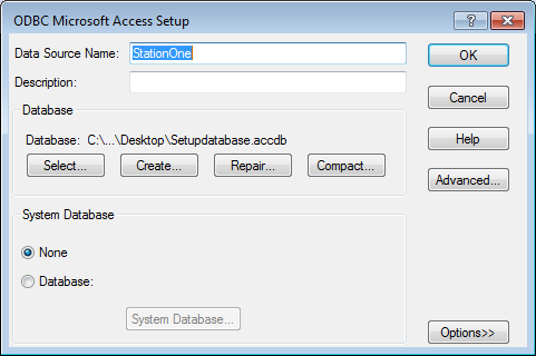

OK, so it's an issue between 32-bit LabVIEW, 32-bit Office (which is what I have here -- I'm pretty sure I've got 64-bit at home), and 64-bit Windows 7.  Let me open the ODBC routine on WOW32 ... Yep, they are there, and the configuration looks OK.  Here's StationOne.
Note that I've set no Advanced Options -- in particular, Login name and Password are both blank.
Wait a minute -- I recall, now, when I opened it "by hand", a message popped up saying "Some Options have been disabled" (or something like that, a Security thing).  I'm going to try to clear that and see if that fixes things ...
BS
