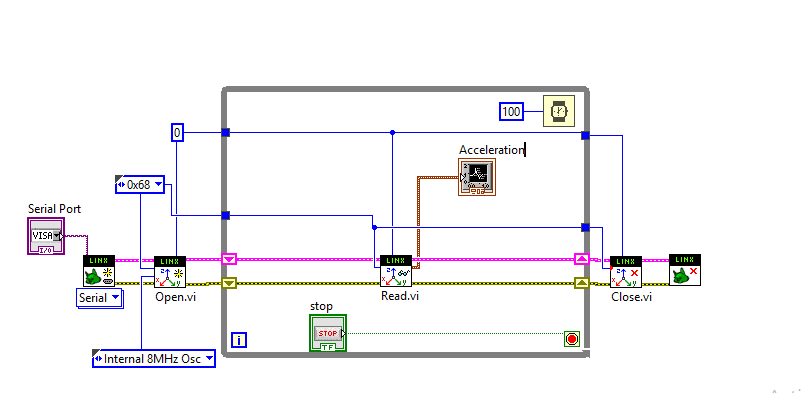

Hello Everyone!!!!, I'm making a project to measure vibrations of a system with Arduino + the accelerometer MPU6050 + LabVIEW + the library LINX.
I new using Labview, but I achieve to do this program with a tutorial :
If I Run the program give me this output:

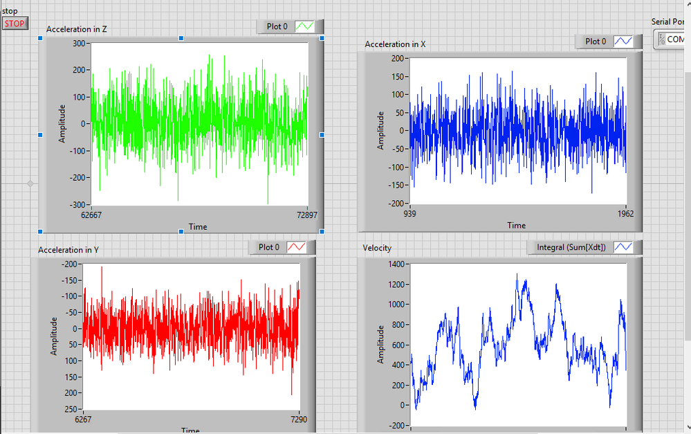

I solved the problem of the offset!!! Now my program is this:
Now I have some problems with the scale of my graphs and with the integration :s, I try to do it, as you can see in the photo above I think that the graph give me a strange result, but the scale don't let me see so well :s
I would appreciate if someone can give me a hand.
(6,217 Views)
It looks like you are still reading the raw I16 binary values from the arduino. You will have to find out the bit resolution of the acutal data (probably 10 bit) and scale that by the range your chip is set to. On the home page they list it as ±2g, ±4g, ±8g, and ±16g. So assuming 10 bit resolution and ±4g, you would need to scale your raw data by a factor of (2*4)/(2^10-1) = 8/1023.
Also are you sure that sensors offset is constant?
I would double check to see if there is any drift. Also it seems (during my brief search) that this device needs a 10-40 second calibration period at startup. Make sure you account for whatever that includes.

Well if I'm honest, I have a little problem later of a while in the 3 graphs, I don't really know why is the reason maybe the offset it's not constant? 😧
This is what I do to know the offset of every graph :
And in that way with the indicators I can know what's the mean, and later subtract it or add them to my graphs, but this seems don't work for a while :s capture 16.png
As you can see, in the graph of X I do this process, but after a while the offset appear again, What I can do? :s
(6,165 Views)
I'm no expert with arduino or accelerometers but they seem to have an extensive (read: long) example of the main arduino page for the device. Lines 270-281 seems to be about setting that directly in a bit register somehow. That should get you started.
As for the step in the baseline after an event, I'm not really sure. Maybe you could get the baseline before and after your event and scale the event linearly? Someone with more experience will have to chime in on that one.
