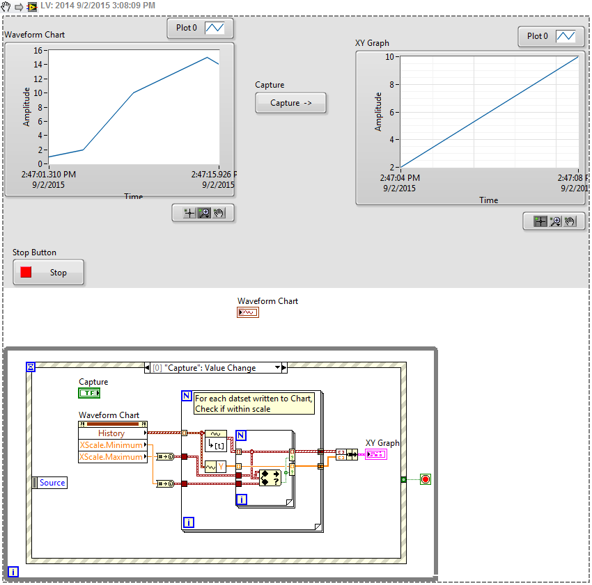

But i need to see the entire data (from t=0 until t=5min) when the VI stops, and sometimes zoom some parts to select which part is valid or not, and then plot the valid part in another graph. It's possible?
My solution would something like that but for waveform chart (wich don't have cursor): https://decibel.ni.com/content/docs/DOC-22642

Since you don't have cursors on charts, it get's a little tricky.
You could use the zoom tools to zoom the chart to a specific range and then have a button to plot the current zoomed range on a graph elsewhere. This would be a simple event trigger by a "Capture" button that pulls the scale Min/Max and grabs that section of the data from the chart and plots it on a chart.

Yes James! This is what i need! But how can be done? I understood what you said but can i implement a event trigger to capture the zoomed chart?
Message 7 of 8
(6,314 Views)
I don't know how your application is set up, but I assume you have some sort of user interface. If it's not using an event structure, shame on you because it should. Smiley Happy
Here's a simple event structure I threw together that should do what you want.
I found it easier to use an XY graph to graph all the individual points. Since your Chart History outputs an array of separate waveforms, it's kind of a pain to sort through them and come out with a single clean waveform with a single dt/t0 that match for a waveform graph...
