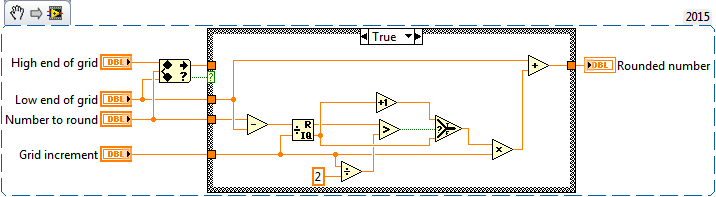

Here's a version that doesn't use arrays, so it theoretically scales to infinity without an increase in memory space or processing time.
(The "False" case just wires the coerce output straight through)
 However it doesn't work with grids that don't have even steps between the numbers, and I don't know if that's a possibility.

Those ideas all seem to work if you are trying to round to a set of specific values.  But you need to define the specifc values for all possibilities.
If you want to round to a specific interval, there is an easier way to do it.
So you want to round to each 0.2.  Divide your number by that interval.  Round to the nearest integer.  Multiply your number by that interval.
If you need to force a number that is lower or higher than a given range to be within that range, such as having 1.255 round UP to 3, then put an In Range and Coerce either before or after this bit of code.

@ziedhosni wrote:
I would like to round numbers following a grid.
Let's say I have a grid of 6 between 3 and 4 ( 3.0 3.2 3.4 3.6 3.8 4.0)
I would like to round to the nearest number of the grid, so if I choose 3.7125, it will be round to 3.8.
Zied,
     Usually when one talks about "rounding", they aren't talking about numbers restricted to a range, say between 3 and 4.  As an example, what would you want 1.55 to round to, 3.0 or 1.6?
     If you want to "round to the nearest 0.2" (and, perhaps, later deal with the question of restricting numbers between 3 and 4), you can "play mathematician" and solve your problem: divide by the interval 0.2 (making them range from 15 to 20), round to the nearest integer, then multiply by the interval (bringing them back to the range 3 .. 4).  As long as you have an evenly spaced grid that lands on an integer, you can use this trick.

This is what the Threshold 1D Array function does - as long as your array of numbers is in ascending order.
