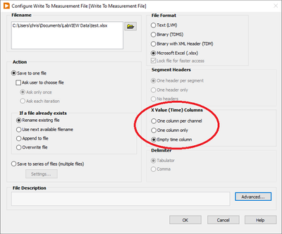

My 6 sensors' output goes to individual "Set Dynamic Data Attributes" and then from there 6 different signals go to "Write to measurement file". When I start the run, I got 6 readings in Excel but now I am missing time (in seconds). May I know how can I include time (seconds) in my coding so that the time display in an Excel file?

"Write to measurement file" has options for a time column (default is empty). What are your settings there?
