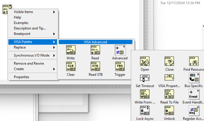

Yes, I can set the timeout = 4s like below. Thank you !

I'd do it like this to preserve the original timeout value:
