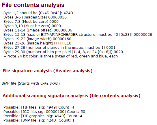

I do not think that your problem is/was a 32bit colour depth. I see 24bit depth. I think that the header of the BMP file is corrupt.
The http://asecuritysite.com/information/bmp site told me the following:
which states enourmous image height at the 23-26th  header bytes.

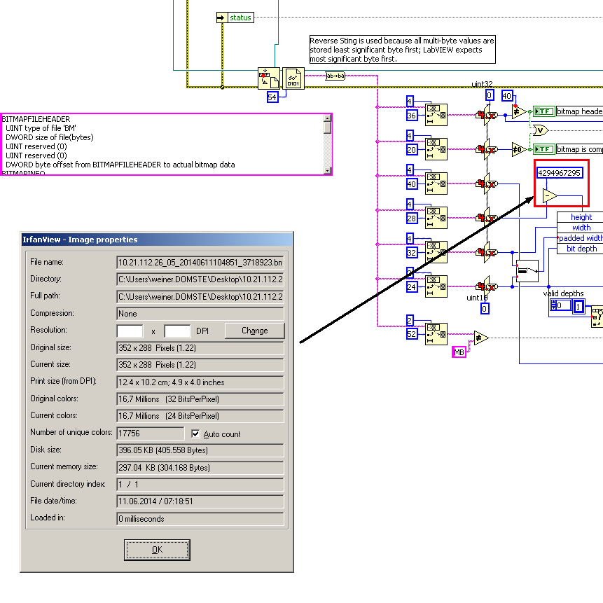

@The header of @nk's pictures results in a counter overflow in one of "Read BMP File.vi"'s SubVis. You could do a work around like this:
Unfortunately, tthere's another issue which I narrow down to "Flip and Pad for Picture Control.vi". The effect look's like this:
If you bypass "Flip and Pad for Picture Control.vi" this results in the following image:
Alex
