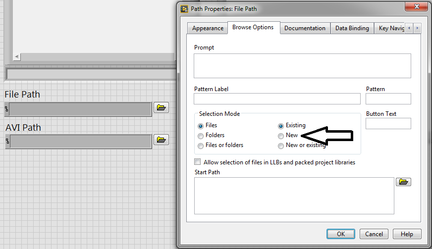

By default, a File browser control set to be able to select existing files. You can can change this behaviour to accept "New" file (see screenshot below).
