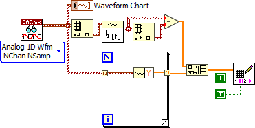

Hi Frank,
I would like to plot the graphs of two lvdts displacement up to time change on A ONE SINGLE Waveform Chart and finally get the results in excell file.
Then why do you converrt the DDT wire to a single waveform, when you want to plot both waveforms/signals?
You should convert to an array of waveforms to get your both signals…
(You should get rid of that DAQAssistent, it will limit you in the end.)
And when you get rid of the Dreaded DAQ Assistant, do not bring back its Evil Twin, the Dynamic Data Wire!  Stick with an Array of Waveforms which will automatically plot "correctly".

Hi frank,
1. Wire the waveform array to your chart…
2. Configure the ExpressVI in the correct way - or do your own data formatting:
(There are other options as well, but that one is done quickly…)
