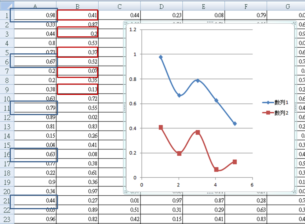

I'd like to use the ActiveX to plot the data in the EXCEL.
With the help of this thread: https://forums.ni.com/t5/LabVIEW/How-do-I-plot-multiple-series-in-Excel/td-p/106580?query.id=1860717
I can make it for simple case.
But my data is not in a row, say I have to plot the cells "A1", "A6", "A11", "A16", ....
As a result, I modify that code it works if the element number is less than 40s, but some error happened when the number exceeds 40s.
Is there any workaround to deal with this problem?

There is a Element Number in a red dashed circle in the following image.
If I set the Element Number to 30, it works fine, but if I set it to 90, it fails.
The range of AA1:AD90 is just for easy to test, in the real case, my range of interest is like A1, A6, A11, A16, A21...(first series); D1, D3, D5, D7, ...(second series); ...

Hi William,
To create a range string of 30 elements takes 30*2+9*1+21*2 + 30*1 = 141 chars.
For 90 cells you need 90*2+9*1+81*2+90*1 = 441 chars: maybe Excel doesn't accept such long strings over its ActiveX interface?
When you know the reference of the chart you could add the plots one by one. This way you can use the full range string for just one plot.
Wouldn't it be much easier to collect all needed data on an additional sheet and then create the chart using a simple range like "A1: D99"???

Yes, I collect all data of interest on an additional sheet to create charts by simple ranges, like "A1:A10", without getting any better way recently.
