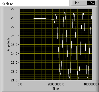

What is that data supposed to represent? If I use an XY Graph like you have in your program, I see the plot below.

Its going to be a plot that represents the Impedance or Phase relative to different frequencies.  The data for it will be recieved from the Network Analyzer and maybe cleaned up to be the reference plot for future acquisitions.  So Impedance or phase relative to different frequencies.  I was unable to see the graph that you just posted after trying to display it on the new transparent graph.
