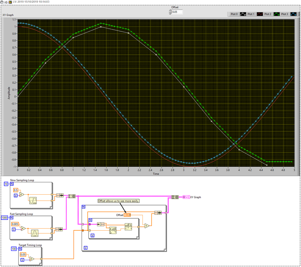

You can probably do this using a combination of Interpolate 1D Array and Threshold 1D Array. The basic idea would be to find out what fractional index of your original array is needed to get the desired time (using Threshold) then interpolate the values array using Interpolate.
I'd just caution you to be careful given the quite different sample rates about how you interpret your output - it may not really be "true", for example.
Below is an example showing this. Note that the last few points (in both cases really, but more noticeable in the slow -> medium case) are not even vaguely valid...
If you wanted to do more complicated interpolation (this is just linear) you can find VIs to do that under the Mathematics palette. The VI used here is the similarly named Interpolate 1D.
In this case, offset is set to 0 to better display the closeness of matching. "cubic Hermite" looks good for this set (sine, cosine) but the method probably depends on the input and perhaps your available time.
