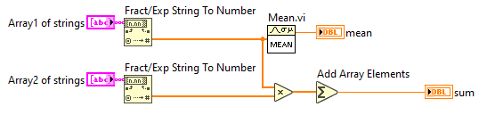

Hi Melanie,
@Melanie23 wrote:
It's a 1D table with strings if it was only numeric in the table I could do the sum but with the strings in it I really don't know how to do it.
So it is a 1D array of strings? ("Tables" are a 2D array of strings in LabVIEW!)
See this:
As you are new to LabVIEW I recommend to use QuickDrop:
When typing <Ctrl-space> a small dialog window opens and you can search for functions by typing just a part of their name.
By pressing <Enter> you can easily drop the selected function in your block diagram…

Hi Melanie,
@Melanie23 wrote:
Please can you send me a snippet or the vi?
Unfortunately I didn't save that tiny VI after creating the screenshot. But I show all the relevant function names so you can easily recreate it!
