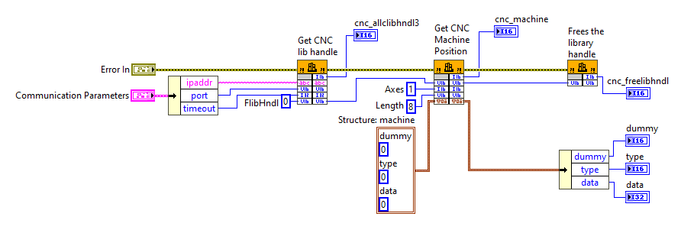

I am trying to use the FOCAS2 library DLL to communicate my computer with a CNC machine and I am using the Call Library Function Node for doing this. I am quite new at DLL management, but various topics in this forum were really useful and helped me a lot. The question I am bringing in here is about getting the values from a pointer to a structure. Here is the DLL function I am bringing for a example:

As I saw on this post at the forum (https://forums.ni.com/t5/Developer-Center-Resources/Passing-and-Receiving-Pointers-with-C-C-DLLs-fro... and https://forums.ni.com/t5/Developer-Center-Resources/Dereferencing-Pointers-from-C-C-DLLs-in-LabVIEW/...), I can receive a pointer and automatically dereferencing it, apparently. So can I automatically dereference a structure, as I did on the VI in attachment? Or the way I did will I get the pointers and not the values?
I did not test this at the machine yet. But, because my time working with the machine is limited, it would be nice to get there with some certainty, in order to avoid waste too much time with some noob errors.

It looks correct, do you get any result?
