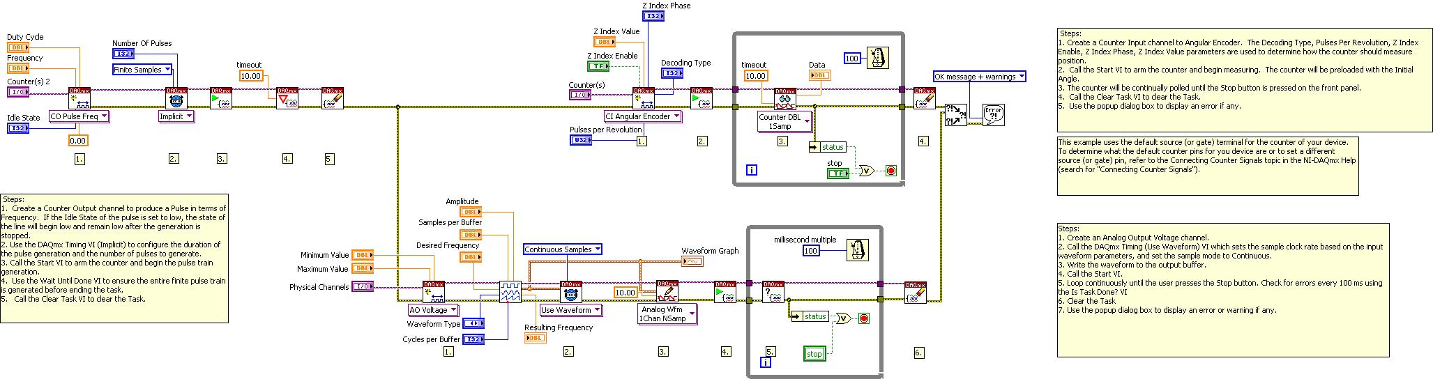

Now, in regards to your question about position measurement and pulse train generation, I have posted a VI that should help you troubleshoot this application. This VI is shown in the image below and is attached as source code. It is a combination of three example programs. These three programs perform an angular position measurement, a pulse train generation and an analog waveform generation (from top to bottom in the image). I just cut and pasted the examples together into one program and ran that. It worked on my M Series Multifunction DAQ device and it should work on your USB-6229 as well. This example program will help determine if your hardware is working correctly and should give you a good building block for your entire application. Let me know if you have any questions.

Hello Matt A.,
  Thanks for your guidance. I need to generate the Finite Number of Pulses, But the VI generates the Continuous Pulses. While Change to Finite generation, the same Error 50103 "The Specified Device was Reserved" was shown by Labview. I read from online help and i am unable to solve the problem. Please give a guidance.

I have modified the code to create a finite pulse train and posted it with this modification. Once again, all I did was cut and paste example programs together to utilize their functionality. This example is simply a combination of the examples called Measure Angular Position.vi, Gen Dig Pulse Train-Finite.vi and Cont Gen Voltage Wfm-Int Clk.vi. I would strongly recommend that you browse the NI Example Finder to become familiar with the programming structure of NI-DAQmx and the general methodology for performing DAQ.
The program I posted, as shown in the image below, does three things. First, it generates a finite digital pulse train. Then, in parallel it generates an analog voltage waveform and measures angular position using a counter. The notes in the Block Diagram should still be applicable, as I have coped them from the shipping examples as well. I have tested this code on my PCI-6251 M Series device and it runs without error. However, you are receiving the error because you are attempting to perform a finite pulse train generation in parallel with your angular position measurement. As discussed in this KnowledgeBase, the finite pulse train generation requires two counters since one acts as the gate for the other. Therefore, ctr0 and ctr1 are in use in the finite pulse train generation when you attempt to access ctr1 for the angular position measurement. You cannot simultaneously perform a finite pulse train generation and an angular position measurement (or any other counter operation) because the NI USB-6229 only has 2 counters. Both of these counters are used for the finite pulse train generation.
However, you can perform your finite pulse train generation, then clear that DAQmx task and perform other counter operations. That is what I have done in the example code and that is why it does not produce an error. Let me know if you have any questions about this example.
