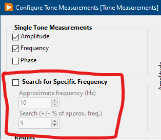

2nd, have you tried using the configuration of the Tone Measurements to specify a "sane" range?

With regards to your second suggestion: I hadn't tried that before. I went ahead and tried it. I tried a variety of different combinations. I estimated my frequency as 4Hz by visually observing the turbine in the flow meter (I couldn't estimate it from the waveform chart because I don't know the units on the horizontal axis). I did try to specify 4Hz as the frequency to look for. No luck there as well.
