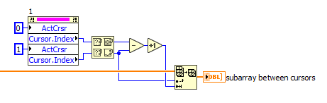

@Ben121 wrote:
Why the fitted curve using polynomial fitting is giving wrong Y axis values?
"Wrong" is a useless word unless you tell us in what way it is wrong (not a good fit, missing, wrong size, wrong alignment, etc.)
I cannot test, because I don't have your data. To get the subset between datapoints of an array, use a locked to plot cursor, and the cursor index property  as follows. Note that the min&max function ensures that the cursor order does not matter.
Message 12 of 14
(807 Views)
