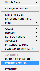

These buttons are ActiveX buttons.
To change their properties, right click on it, and select Property Browser...
Please be aware that TestStand owns them.  Any changes may be overwritten by TestStand at runtime.
If you want to use a native LabVIEW button, you can use the ActiveX button method => Do Click to start the sequence when your button got clicked.
However, you have to take care other properties (such as diable when sequence start run) of your button yourself.
