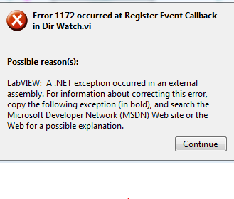

I saw the SteveChanler nugget, but it complains about .NET assembly version (it wants 2.0, and I have 4.0 on my system).
When I run it, it generates error 1172, then does nothing until I STOP the program, where it reports the error.
The error message is particularly useless, referring to a non-existent information, and telling me to go search.
I found another example elsewhere, called File Watch.  It's less comprehensive (has only the CREATED event), but actually works.
