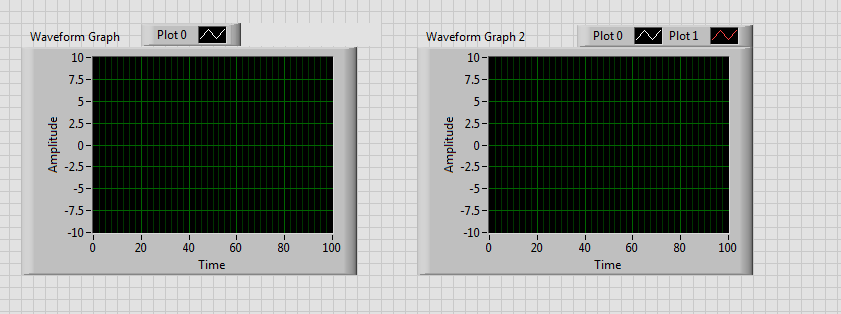

You can create a custom control and replace the control with your own image that matches the background. Then place this control over the extra legend item(s) to hide it. This is a little tricky to describe so I made you  an example:
When run, the legend cover blends in with the background and the legend.
I made a boolean, then went to Advanced > Customize. I then copied a screenshot section that I took of the edge of a legend in to replace the normal boolean picture. Placing this boolean just right, you can cover up one end of the legend and if you disable the boolean the user won't be able to click it. When you need more or less than 1 legend element, you can hide the boolean programmatically.
It takes some finagling with the picture (I used paint), but I bet you can get it just right if you spend some time on it.

James, that's a wonderful solution, and very interesting way of thinking. I could have never thought of that.
The attached vi has a very cool name for a vi, by the way 🙂
Thanks a lot.

No problem! I just realized you will need to handle the zero case as well since you can't set legend size to zero. So in that case, hide the legend and hide the boolean. This should mean your legend size never gets set below 2.
