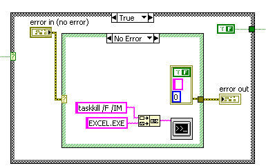

I have a VI which takes measurements and store them in an Excel worksheet after some numerical manipulations. I have been very careful to close anything in the correct order before making an "Application Quit" at the end of the Labview VI
The VI is running well and as many times as we want as long as no Excel application has been left open (opened by hand to check data for example) before running the labview VI.
So presently I have to be careful that no Excel application is open before I start the VI.
Can someone tell me how my Labview VI can detect (at the starting) if an Excel application is already open and then close it in case yes ?
Thank you
Youki

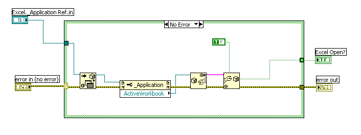

Here you go,
cheers
Message 2 of 8
(9,320 Views)
Addendum: Alternatively, to check to see if Excel is running you can use System Exec to issue the tasklist command and then search the output for "excel.exe".

hello,
What are the names of the two VIs which are shown in the picture after ActiveWorkbook ?
I tried to find these in variant pallette, but was not able to.
Please let me know the VI names.
Thank you
Message 4 of 8
(8,297 Views)
They are Flatten to String and Unflatten From String. In the Numeric-> Data Maipulation.

(7,543 Views)
I tried the code that you suggested on LabVIEW 2015. It returns only false in all scenarios! any alternate methods except SystemExec method?
Message 7 of 8
(6,238 Views)
Instead of Checking for the Active Work book, try to find the list/Count of Workbooks and Extract the required workbook name and use workbook close option via Automation refnum property.
