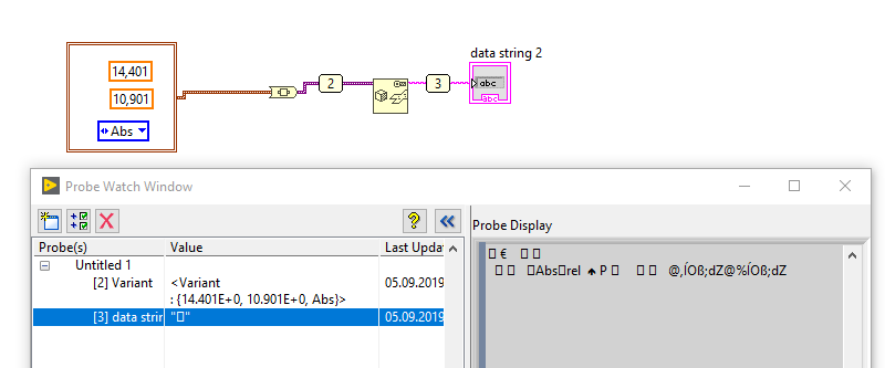

As rolfk explained the conversion seems to be done in a 'LabVIEW'-internal format.
Since we don't know the format of your variant, and that serialisation isn't a open format like protobuf
your client and application are linked. (So a future requirement migth be to add a protocol definition;) )
A quick try get me to this:
  My guess got quite close  😉 , however the "Abs" seems to be predefined in an other way...
You have the sources... that already help a lot. The 'easy way' if you need a link to another client app would be to write a wrapper in that LabVIEW version ...if you can't change the main application.
I don't know how many different message types you have, but this type looks quite simple...  (if you use a custom probe with a string set to hex display , I bet you identify 3 numbers (two floating and a I32?) 😉
However, if client and application got recompiled to another LV version that migth change.

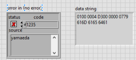

So, Variant to flatten data and Flatten data gives the exact same result. As mentioned it's a pure byte conversion sent as text, in this case:
01 - 1 byte for Boolean
00 00 04 D3 - 4 bytes for the integer with the Error code
00 00 00 07 - 4 bytes for the integer saying how long the string is
7961 6D61 6564 61 - 7 bytes with the string.
Changing the string indicator to 'normal' mode is useless in this case.
